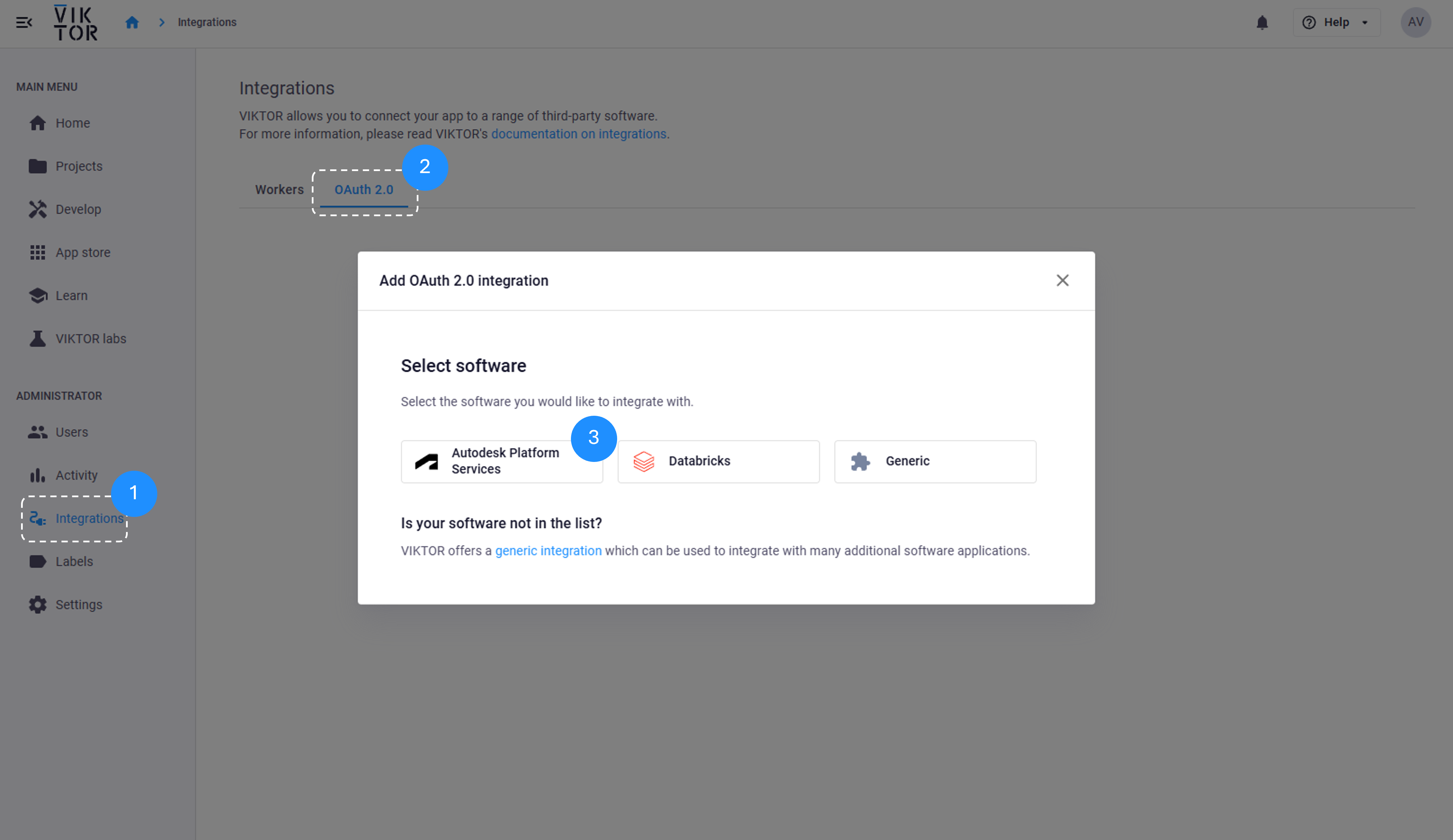

  1. Navigate to the Integrations tab in the Administrator panel.
  2. Select the OAuth 2.0 tab.
  3. Follow the steps in the modal:
    1. Select Autodesk Platform Services.

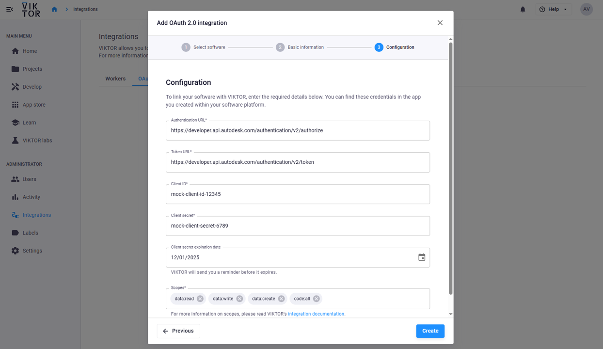

    3. Then, in the "Configuration" tab add the Authentication URL and Token URL as follows:
    4. If you already have an active APS application, you can fill in the client ID and secret, as well as the scopes and expiration date, if you do not have one, continue to the next step to create and set up the APS application.

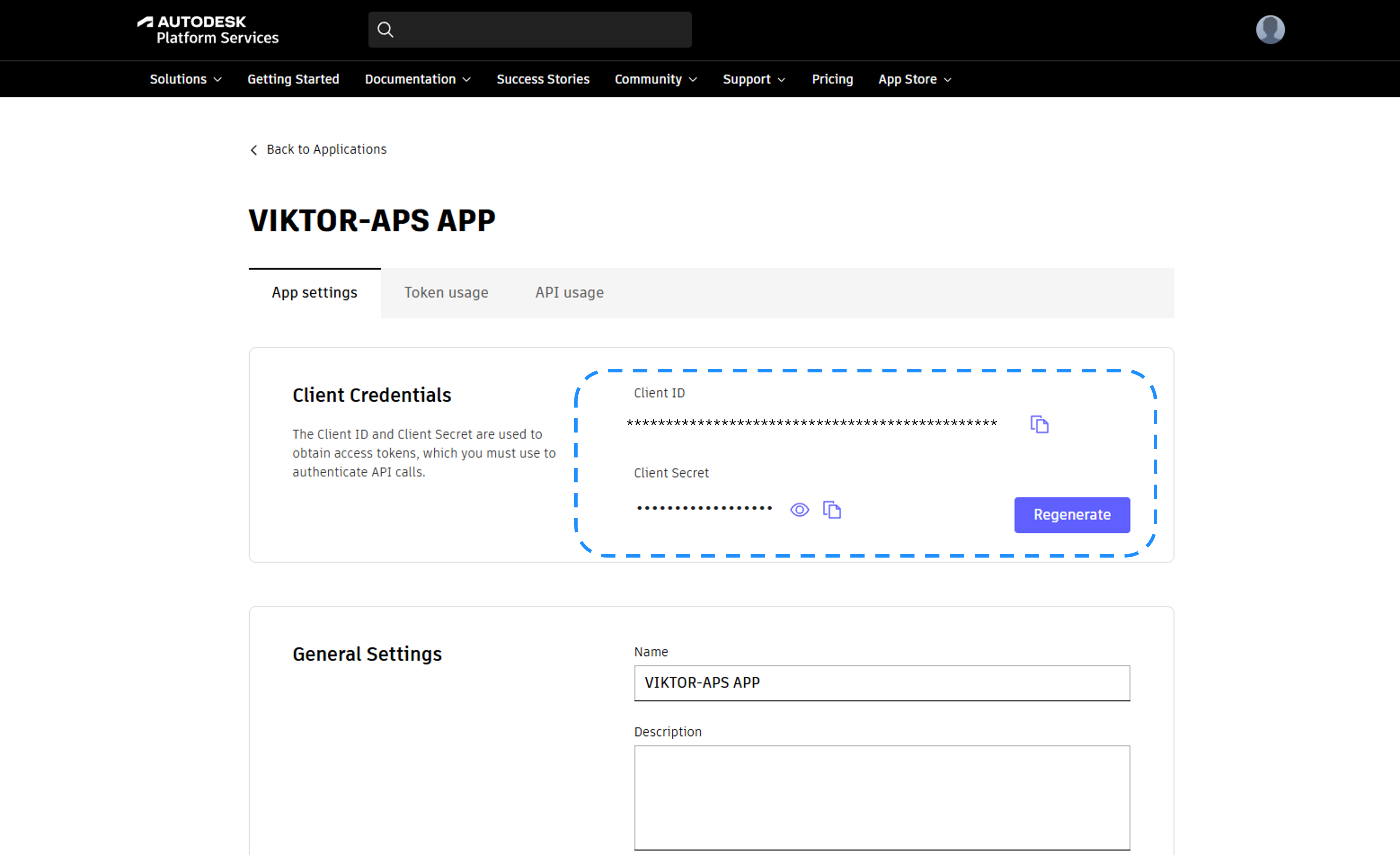

  5. In the APS application, open App settings and copy Client ID and Client Secret into the VIKTOR modal from step 3.

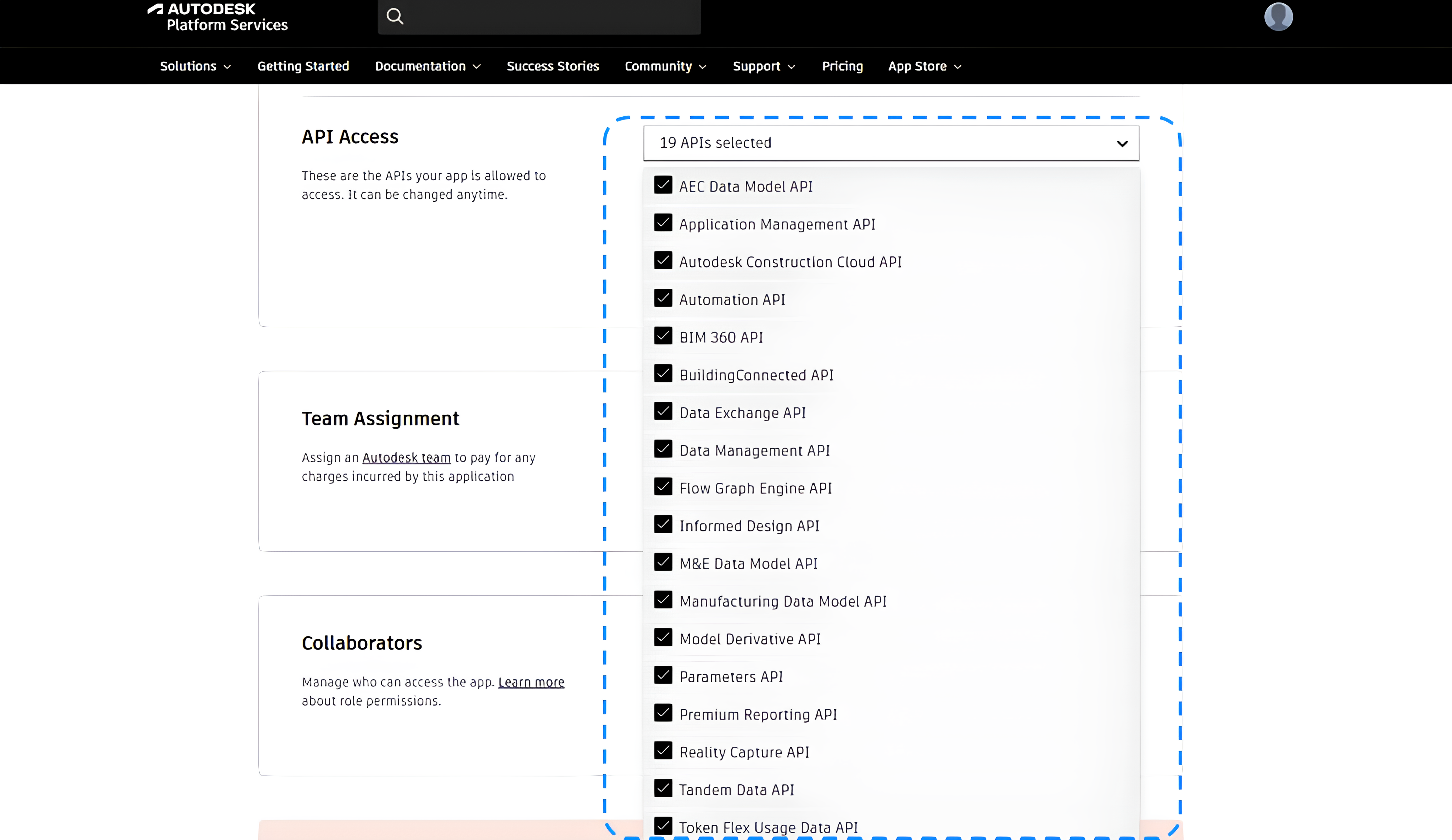

  7. Open App access and select the APIs you want your application to access.

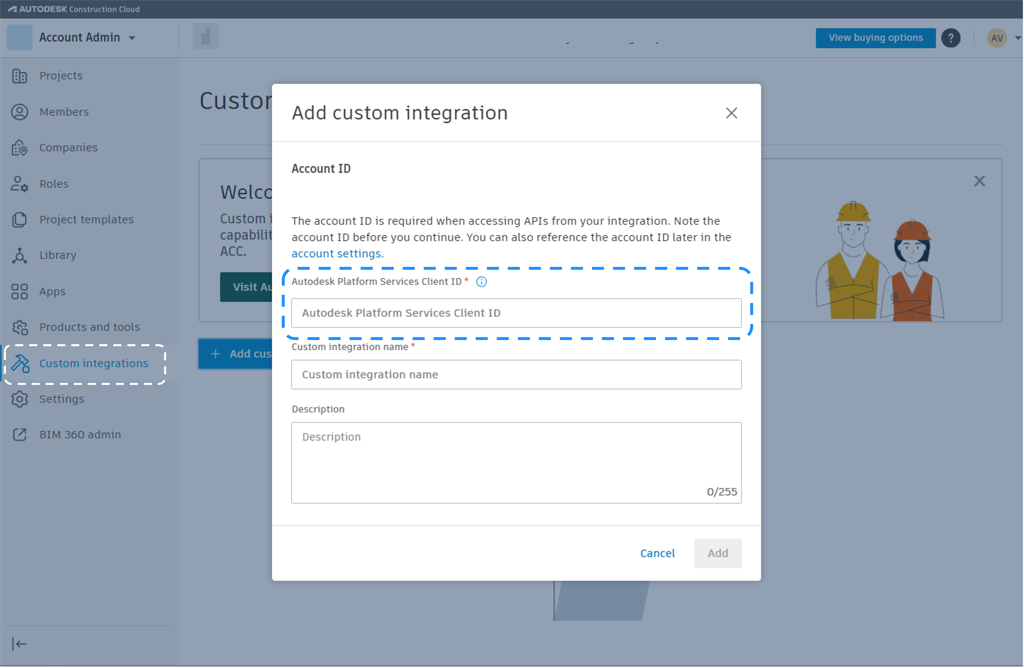

Your VIKTOR-APS integration can connect to Autodesk Construction Cloud using Custom integrations. A custom integration connects your Autodesk Construction Cloud account to your APS application.
The user must be an Account Admin to add the app integration. Follow these steps to connect your APS application to your ACC projects:
  1. Log in to your ACC account.
  2. Open Custom integrations and click Add custom integration.
  3. Enter the APS Client ID from the previous section.
  4. Enter a name and a description for the custom integration.
  5. Complete the integration by clicking Add app.
