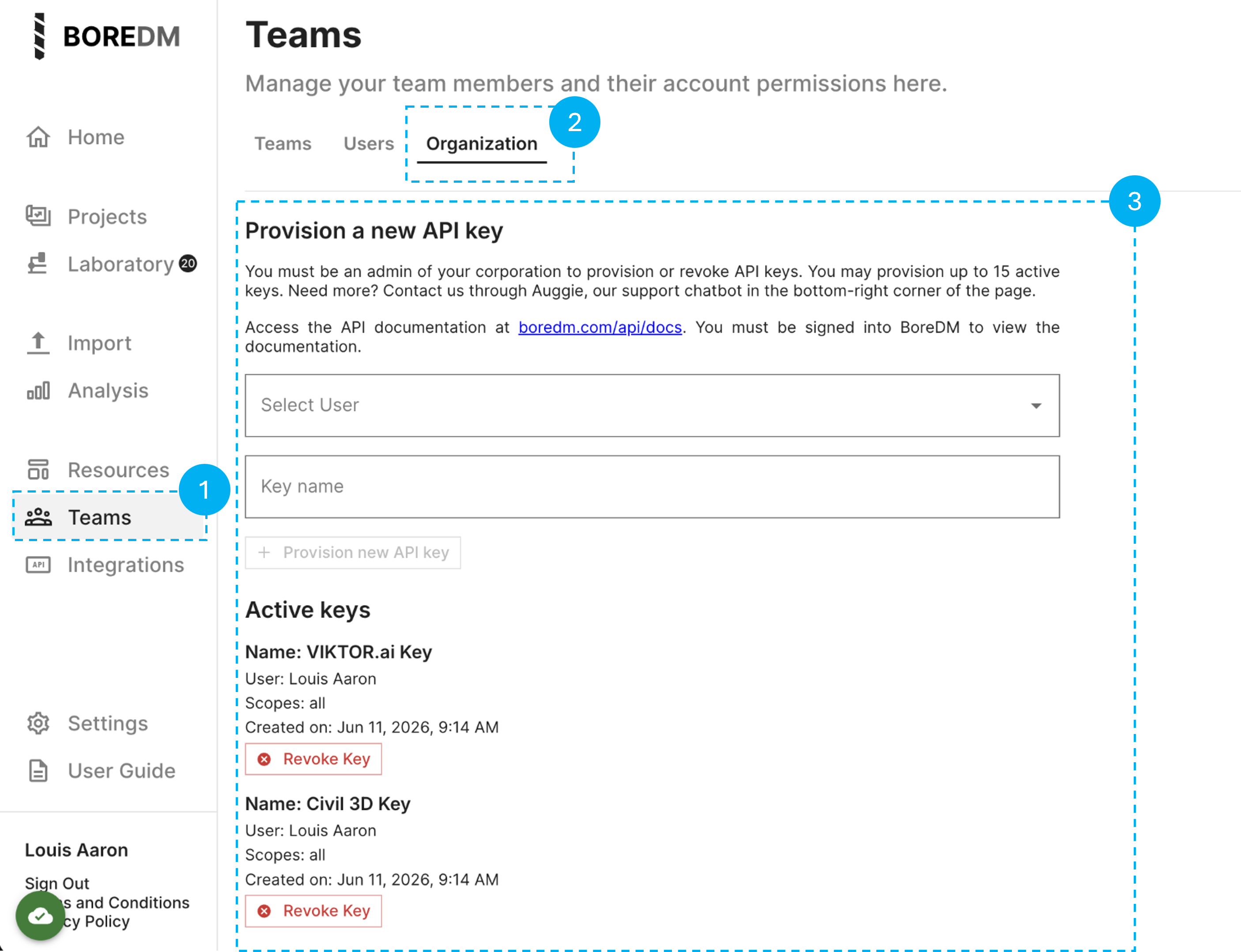

Getting a BoreDM API key​
To use the BoreDM API, you need to provision an API key from your BoreDM account. Follow these steps:
  1. Navigate to Teams - In the BoreDM sidebar, click on Teams under the Resources section
  2. Open the Organization tab - Click on the Organization tab at the top of the page
  3. Provision a new API key - Select a user, enter a key name, and click + Provision new API key
BoreDM API key provisioning interface
