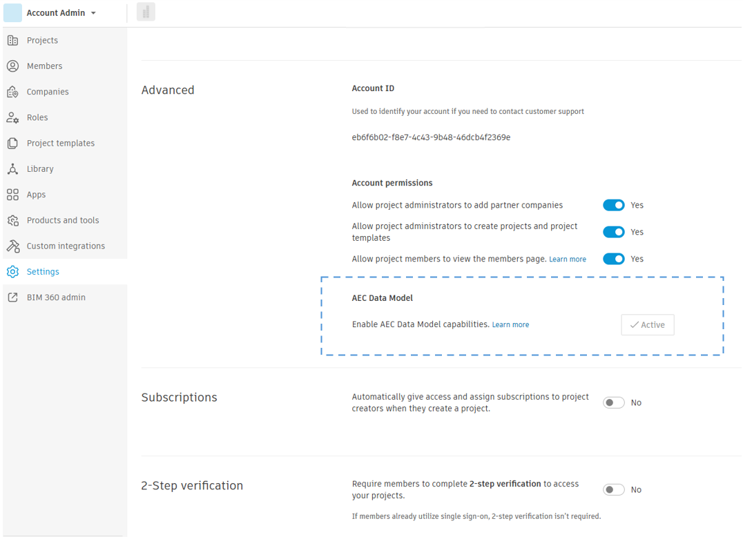

Activating the AEC Data Model​
Before using the AEC Data Model API, it must be activated in your ACC account by your ACC Account Administrator. Contact your admin and request that they activate the AEC Data Model for your account. The admin can do this by going to Settings in the Account Admin page and toggling the "Enable AEC Data Model capabilities" option. It is not active by default. You can follow the complete onboarding guide for detailed steps.

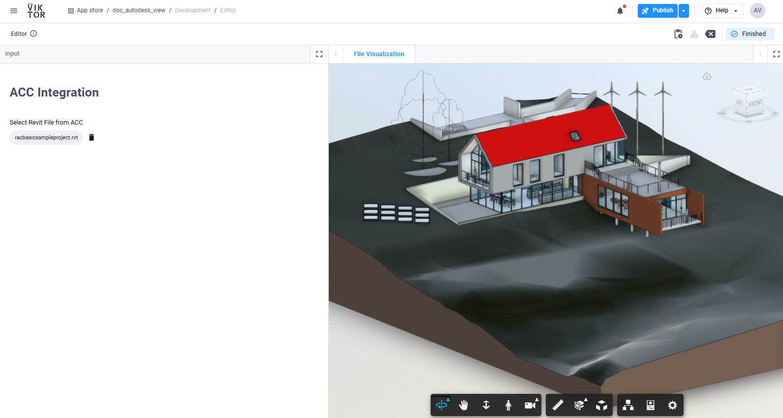

With just a few lines of code you can create an app that lets you select a file from your ACC hub and view the Revit model:
revit_file = vkt.AutodeskFileField(
"Select Revit File from ACC",
oauth2_integration="aps-integration-1"
@vkt.AutodeskView("File Visualization")
def visualize_file(self, params, **kwargs):
if not params.revit_file:
raise vkt.UserError("Please select a Revit file from ACC")
return vkt.AutodeskResult(params.revit_file, oauth2_integration="aps-integration-1")
The integration name in oauth2_integration must match the value in viktor.config.toml. The ACC custom integration must be added in Account Admin, and the user must have access to projects in that account.

@vkt.TableView("Data Exchanges")
def get_data_exchanges(self, params, **kwargs):
integration = vkt.external.OAuth2Integration("aps-integration-1")
token = integration.get_access_token()
# Step 1: Get first hub
hubs = self.get_hubs(token)
if not hubs:
return vkt.TableResult([["No hubs found", "", ""]], column_headers=["Exchange Name", "Exchange ID", "File URN"])
first_hub_id = hubs[0].get("id", "")
# Step 2: Get first project from hub
projects = self.get_projects(token, first_hub_id)
if not projects:
return vkt.TableResult([["No projects found", "", ""]], column_headers=["Exchange Name", "Exchange ID", "File URN"])
first_project_id = projects[0].get("id", "")
# Step 3: Get folders from project
folders = self.get_project_folders(token, first_project_id)
if not folders:
return vkt.TableResult([["No folders found", "", ""]], column_headers=["Exchange Name", "Exchange ID", "File URN"])
first_folder_id = folders[0].get("id", "")
# Step 4: Get folder content (including data exchanges)
folder_content = self.get_folder_content(token, first_folder_id)
exchanges = folder_content.get("exchanges", {}).get("results", [])
# Check if no exchanges found
if not exchanges:
return vkt.TableResult([["No exchanges found in this folder", "", ""]], column_headers=["Exchange Name", "Exchange ID", "File URN"])
# Prepare table data
rows = []
for exchange in exchanges:
exchange_name = exchange.get("name", "")
exchange_id = exchange.get("id", "")
alt_ids = exchange.get("alternativeIdentifiers") or {}
file_urn = alt_ids.get("fileUrn", "")
rows.append([exchange_name, exchange_id, file_urn])
return vkt.TableResult(rows, column_headers=["Exchange Name", "Exchange ID", "File URN"])
