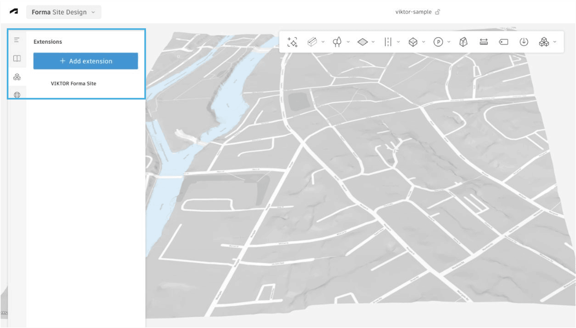

  1. Open the target Forma project and go to Extensions → Add extension.
    Open the Extensions panel in Forma Site Design

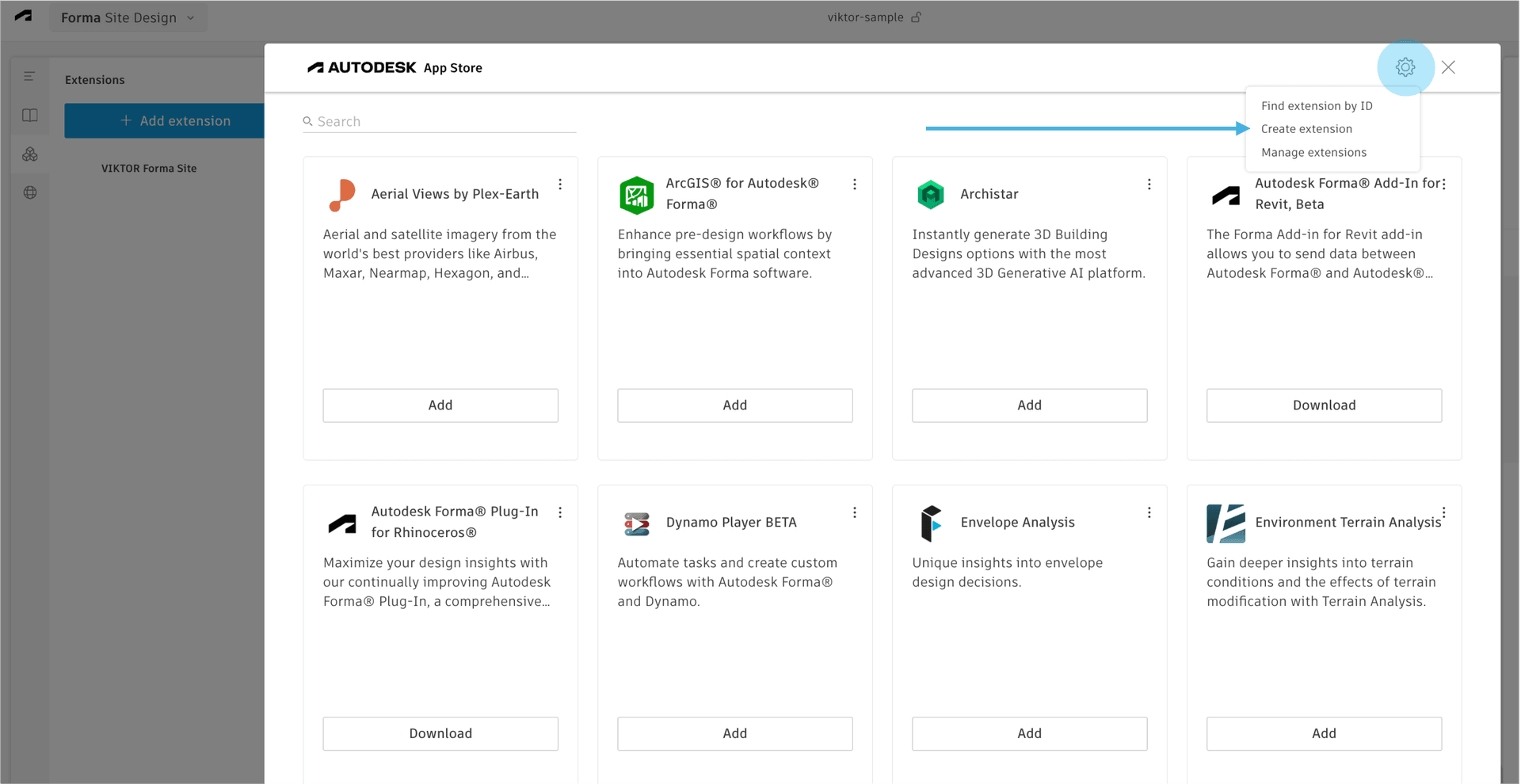

  2. In the Autodesk App Store dialog, select the settings icon in the upper-right corner and choose Create extension.
    Create a new Forma extension

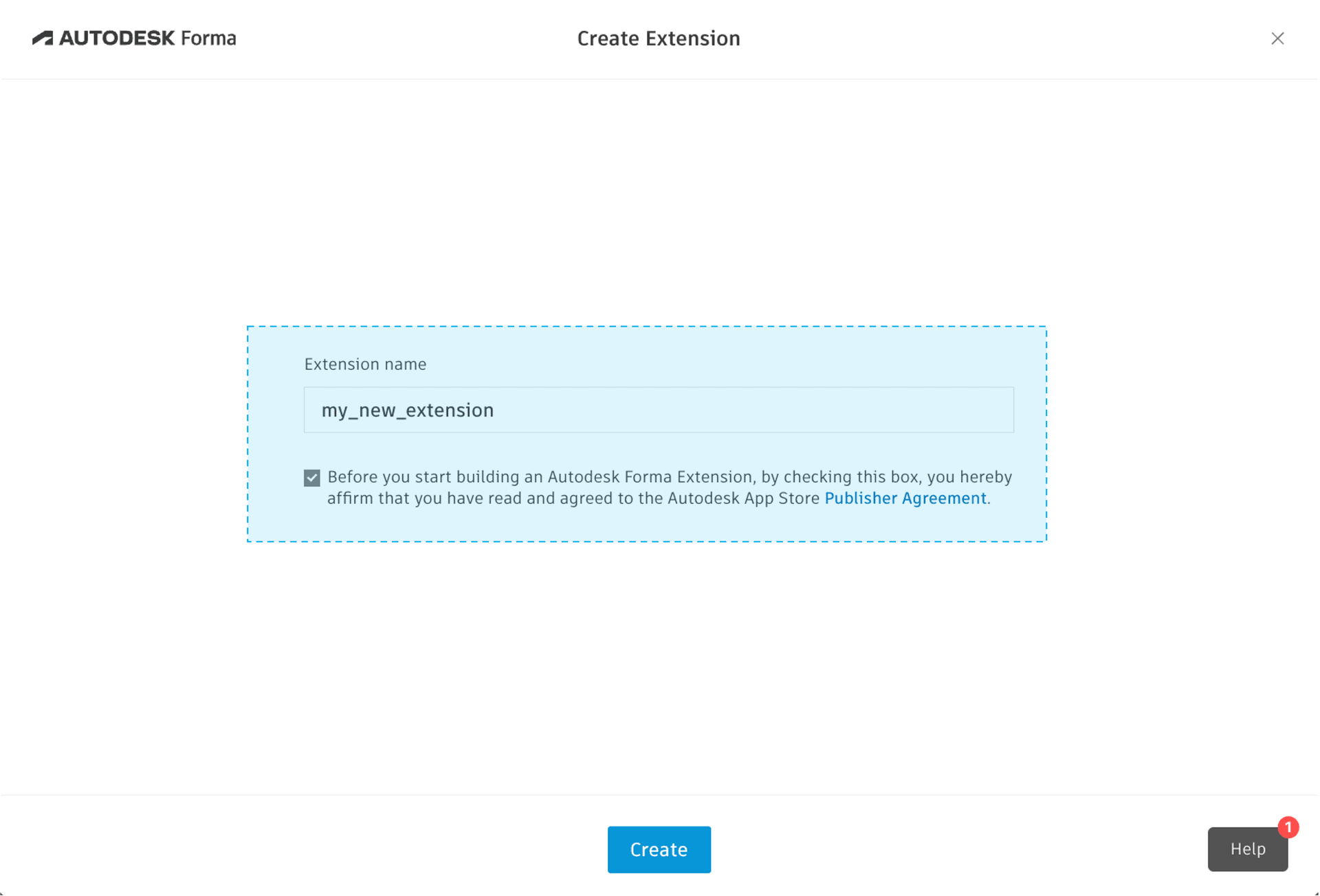

  3. Name the extension, accept the Publisher Agreement, and select Create.
    Enter the new Forma extension details

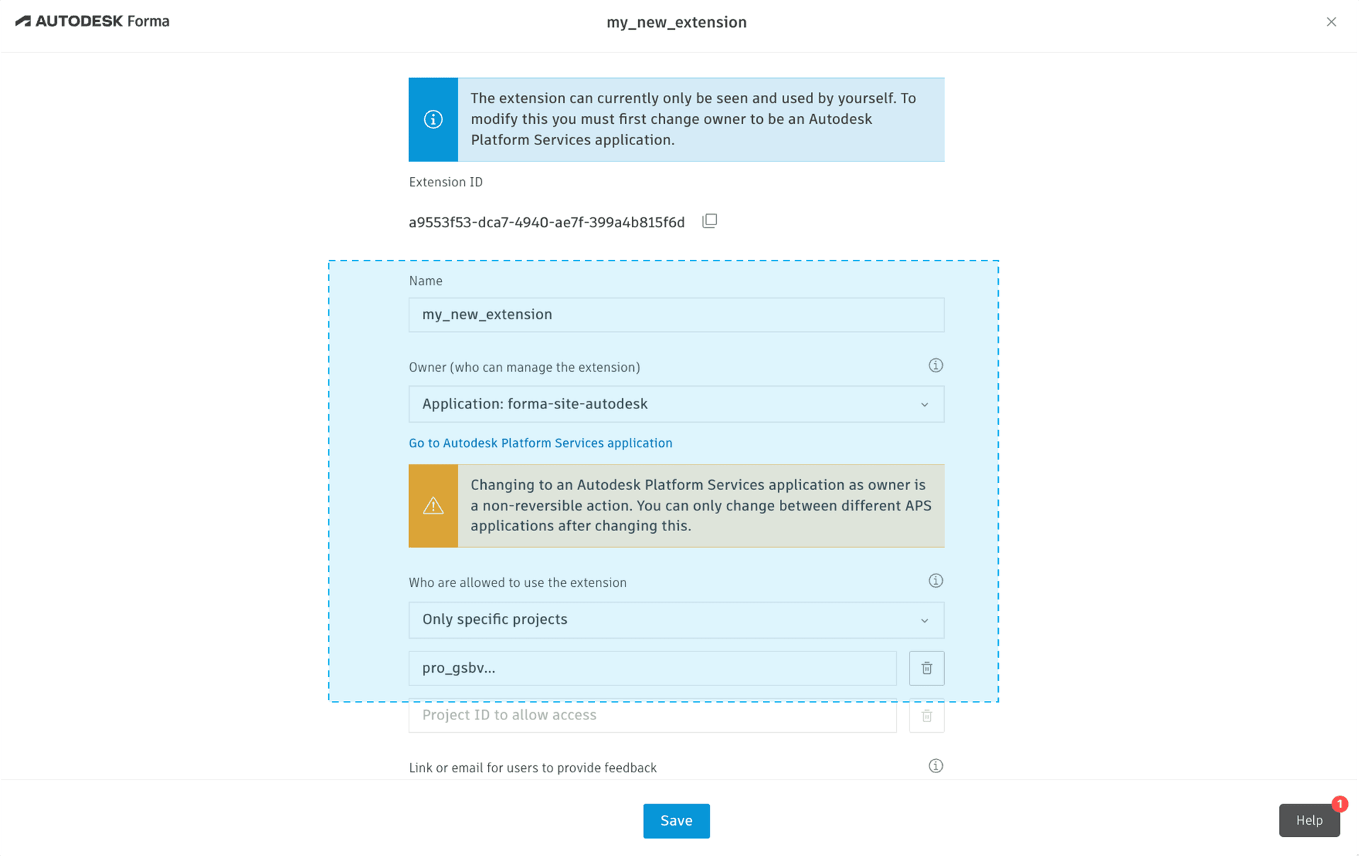

  4. Set the extension owner to the APS application used by the VIKTOR integration. In this guide, that application is Application: forma-site-autodesk. Limit access to the required Forma projects, or allow all Forma users when appropriate.
    forma-site-autodesk is the display name assigned when the APS application was created on the APS applications page. Your APS application may have a different name; select the application whose client ID is used by the VIKTOR integration.
    Configure the Forma extension owner and project access
    Owner (who can manage the extension) provides these options:
    • Myself only: the current Autodesk user owns and manages the extension.
    • Application: APS application name: transfers ownership of the extension to the selected APS application. This guide uses Application: forma-site-autodesk; select the APS application associated with your own VIKTOR OAuth 2.0 integration.
    • Manage APS Applications: opens the APS application management page.
    Who are allowed to use the extension provides these options:
    • Only specific projects: limits the extension to the selected Forma projects.
    • All users of Forma: makes the extension available to all Forma users in the environment.
    This setting controls where the extension can be used; it does not replace installing the extension in each target project.
    warning
    Transferring extension ownership to an APS application is non-reversible. Confirm that you selected the APS application associated with your VIKTOR integration before saving.

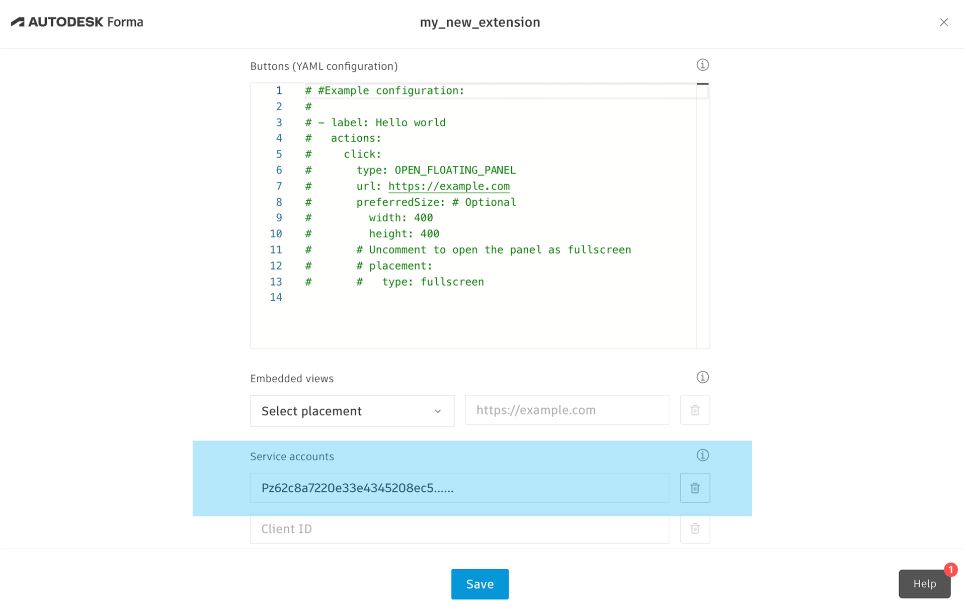

Open the extension Integration settings, add a service account, and enter the same APS client ID used in VIKTOR and ACC.
Add the APS client ID as a Forma service account

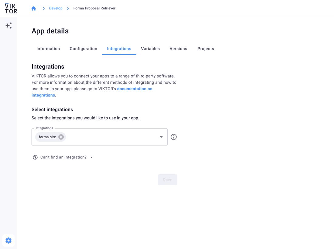

After submitting the prompt, assign the integration to the app:
  1. Open App details in the App Builder.
  2. Open the Integrations tab and select the OAuth 2.0 integration named forma-site.
  3. Save the selection and connect the integration when prompted.
Assign the Forma Site integration in App details

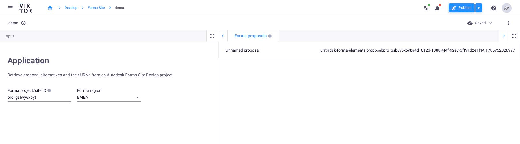

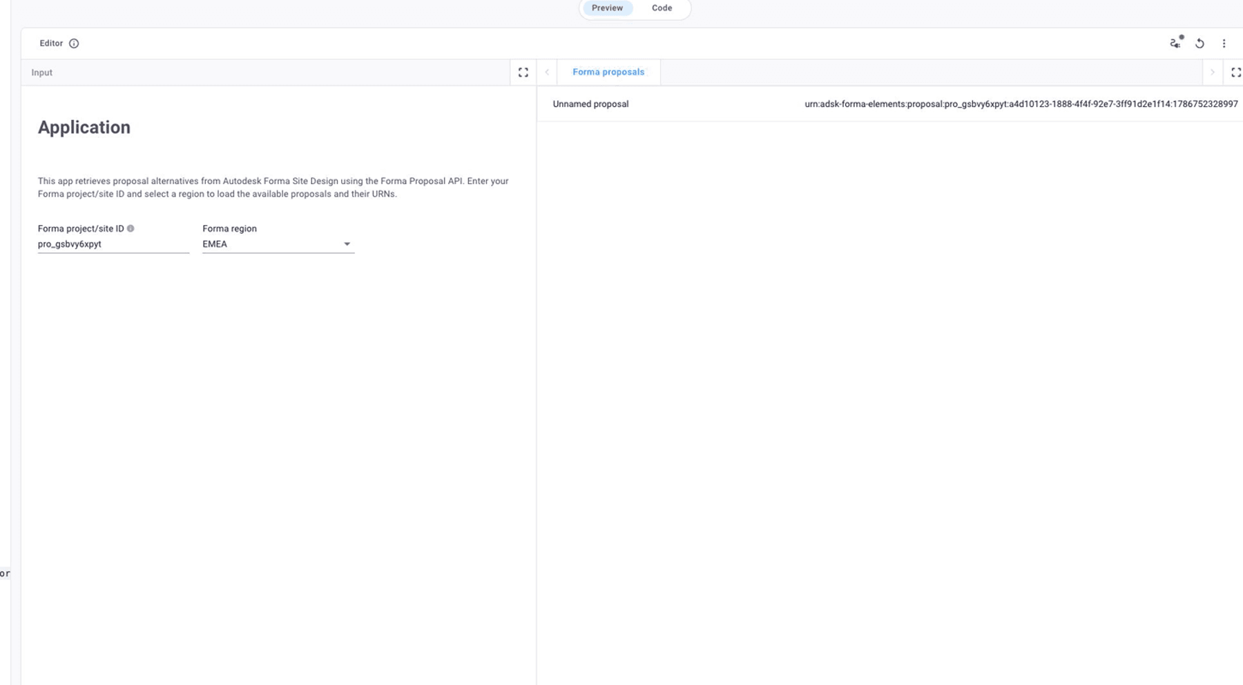

A generated App Builder result can look like this:
App Builder result for an Autodesk Forma proposal lookup app

Enter the project/site ID from the Forma URL and select the matching region. The view then lists the available proposal alternatives and their complete URNs.
A VIKTOR DataView listing Autodesk Forma proposal URNs
