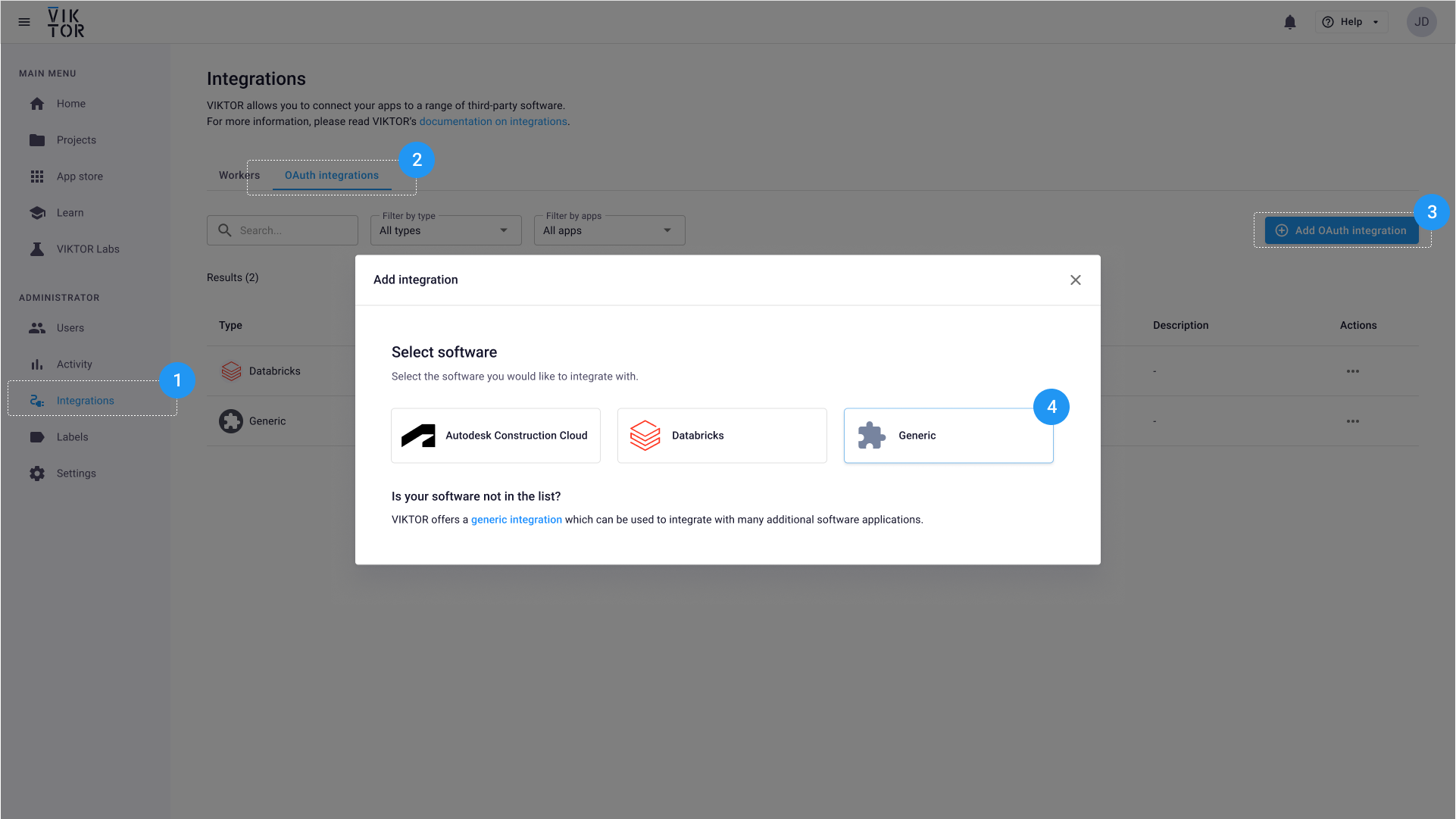

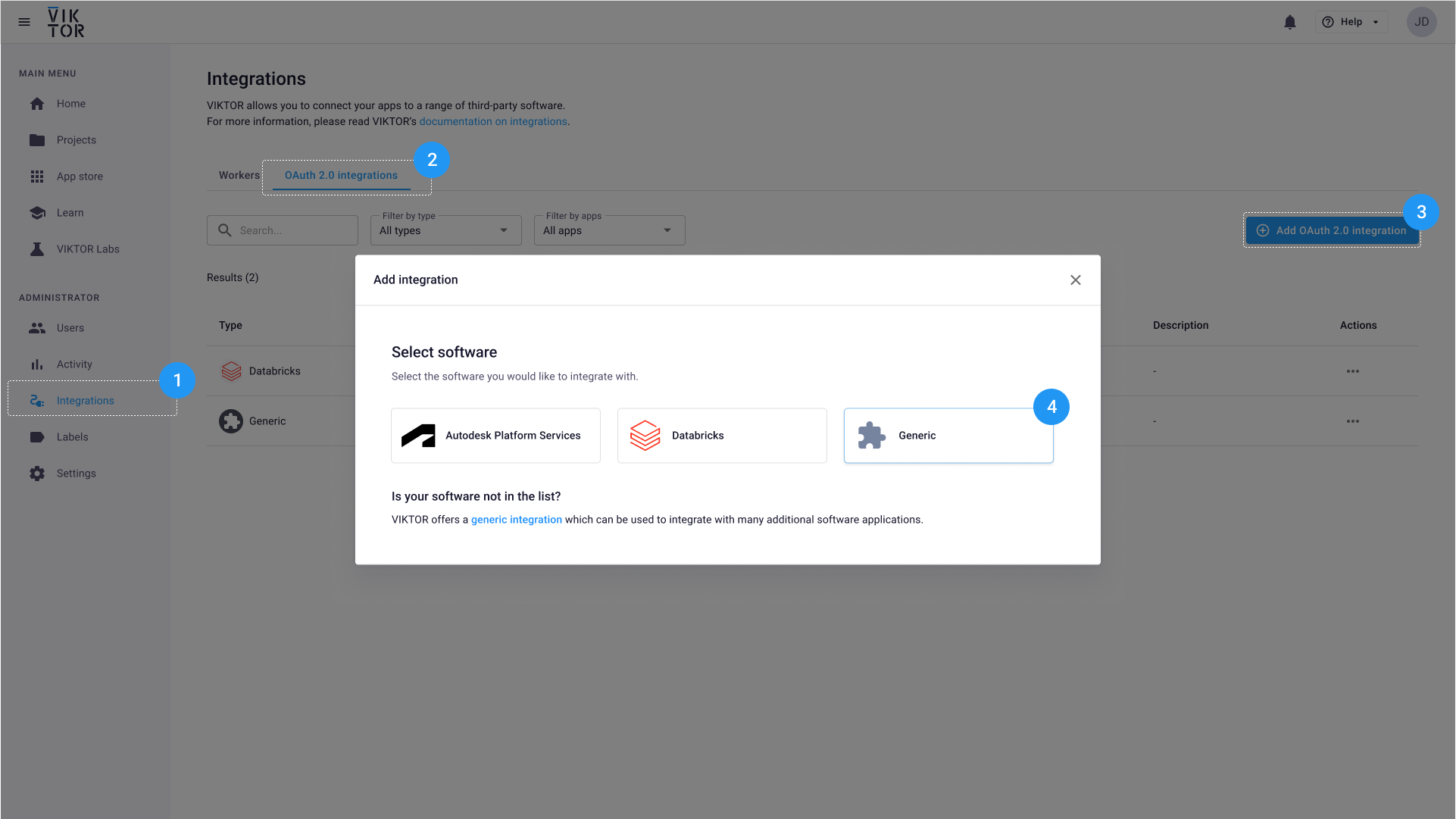

Creating a generic OAuth 2.0 integration (admin)​
First a generic OAuth 2.0 integration needs be setup by one of the VIKTOR admins. This needs to be done in the third-party software and VIKTOR.
  1. Navigate to the "Integrations" tab in the Administrator panel
  2. Select the "OAuth 2.0 integrations" tab
  3. Click "Add OAuth 2.0 integration"
  4. Follow the steps provided in the modal
    1. Select "Generic"
    2. Fill in the basic information of the integration, including the app that the integration should be available to. You can choose to limit the integration to specific apps or allow all apps on the environment to use it.
    3. Fill in the credentials needed to establish a connection. These credentials can found in your third-party software app.
