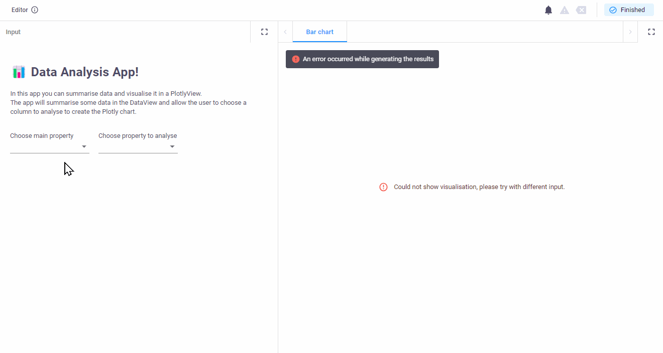

    3. Add Input fields​
    We want the CEO to interact with the app. For this, we will add two OptionFields. One to determine the variable on the X-axis and the other for the Y-axis. Also, we will make sure that the showed options correspond to the columns of the data set.
    Remember, we always add input fields in the Parametrization class.
    1. In the app.py file make sure the code in the Parametrization class looks like this:
      introduction = vkt.Text(
      # 📊 Data Analysis App!
      In this app you can summarise data and visualise it in a PlotlyView.
      The app will summarise some data in the DataView and allow the user to choose a column to analyse to create the Plotly chart.
      # Add some input field for the user
      main_column = vkt.OptionField('Choose main property', options=extract_data().columns.values.tolist())
      count_column = vkt.OptionField('Choose property to analyse', options=extract_data().columns.values.tolist())
      class Controller(vkt.Controller): # <--- this line is for your reference
    2. Go to your cloud environment (e.g. cloud.viktor.ai) and open the development card. Great! You will be able to see your input fields.
    How the app should look after the parametrization
