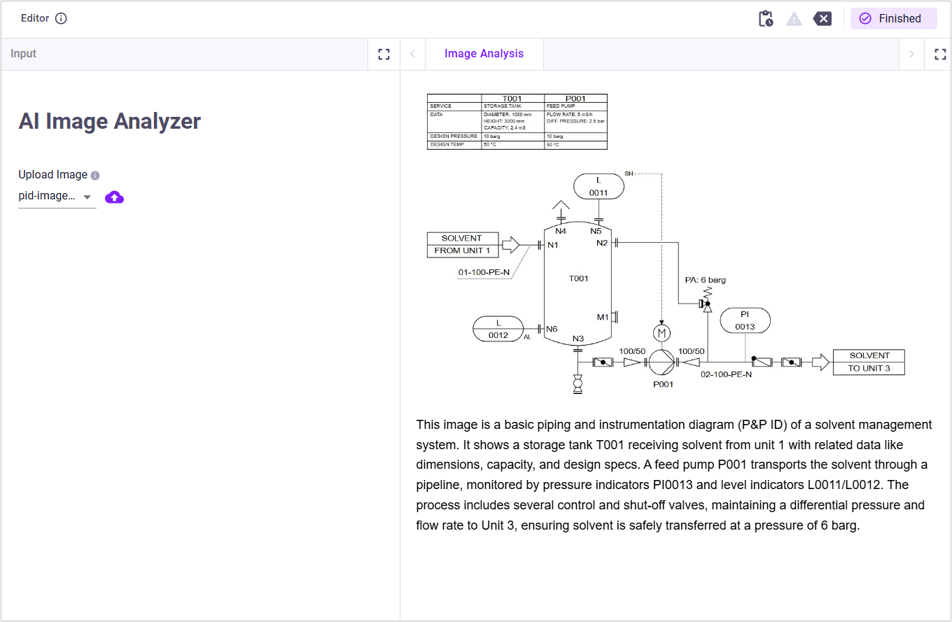

This is how your application should look:
Sample app showing image analysis with vision LLM
