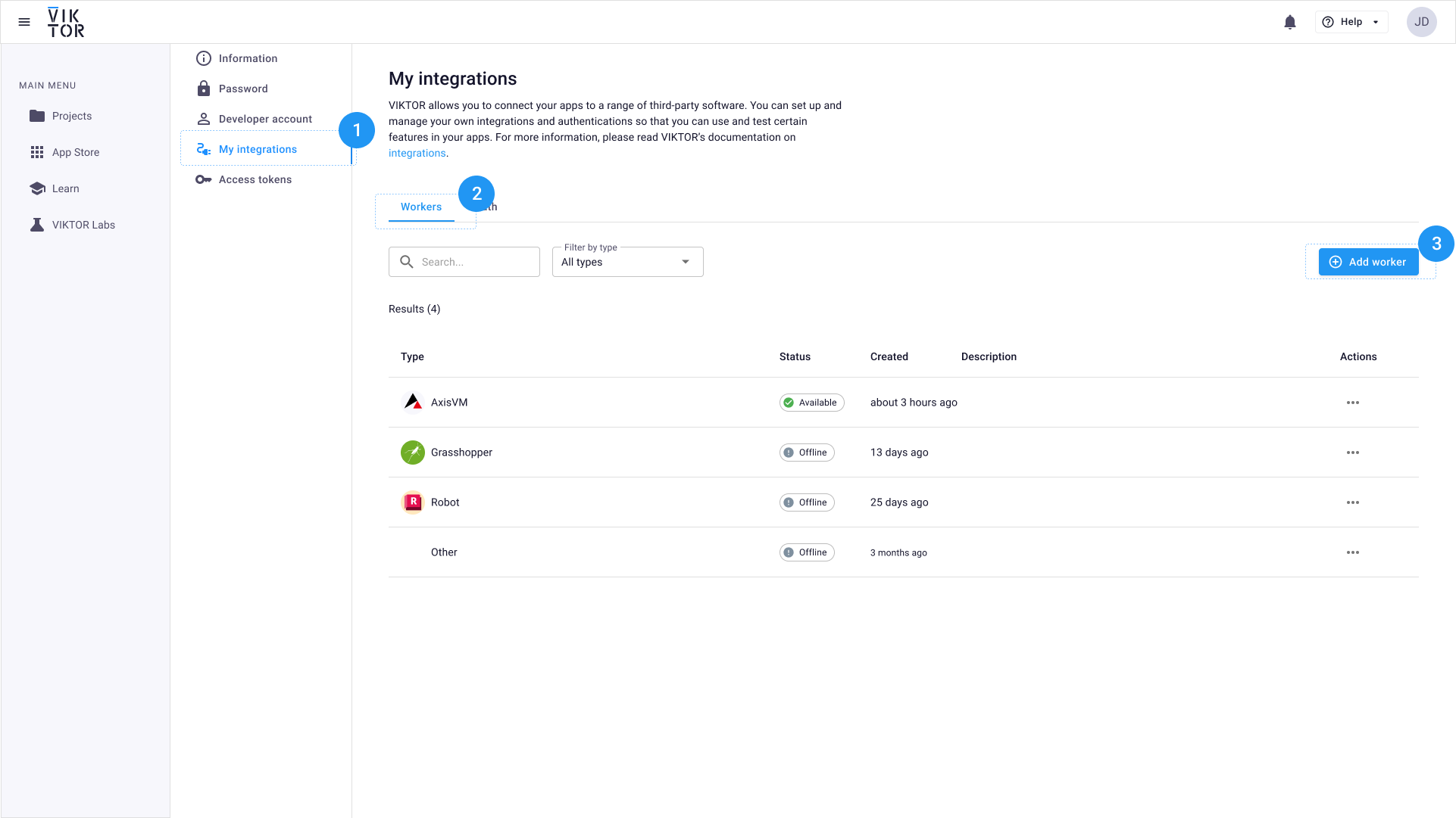

A personal worker connects the software that is installed on your own machine, for your own use. Personal workers are installed and managed with VIKTOR Desktop: one app to install, authenticate, run, and monitor all your personal workers.

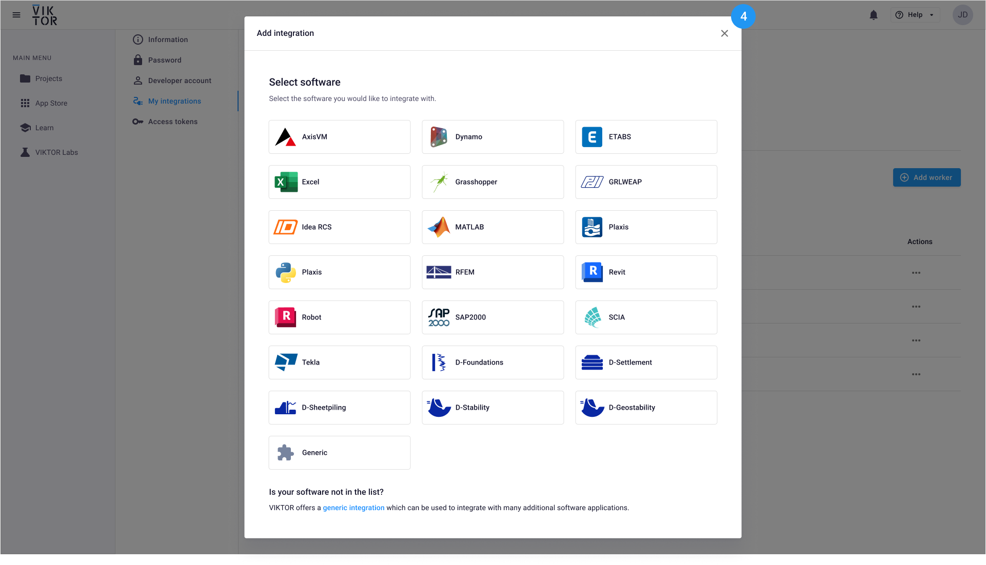

- Download VIKTOR Desktop (a single signed .msi Microsoft Installer) from the "My integrations" tab in your personal settings, or directly from the VIKTOR Desktop page, and install it (first time only)
- Launch VIKTOR Desktop and log in with your VIKTOR account via the browser
- Click "Add" and select the software of choice
- Follow the instructions to complete the worker configuration
- Start the worker

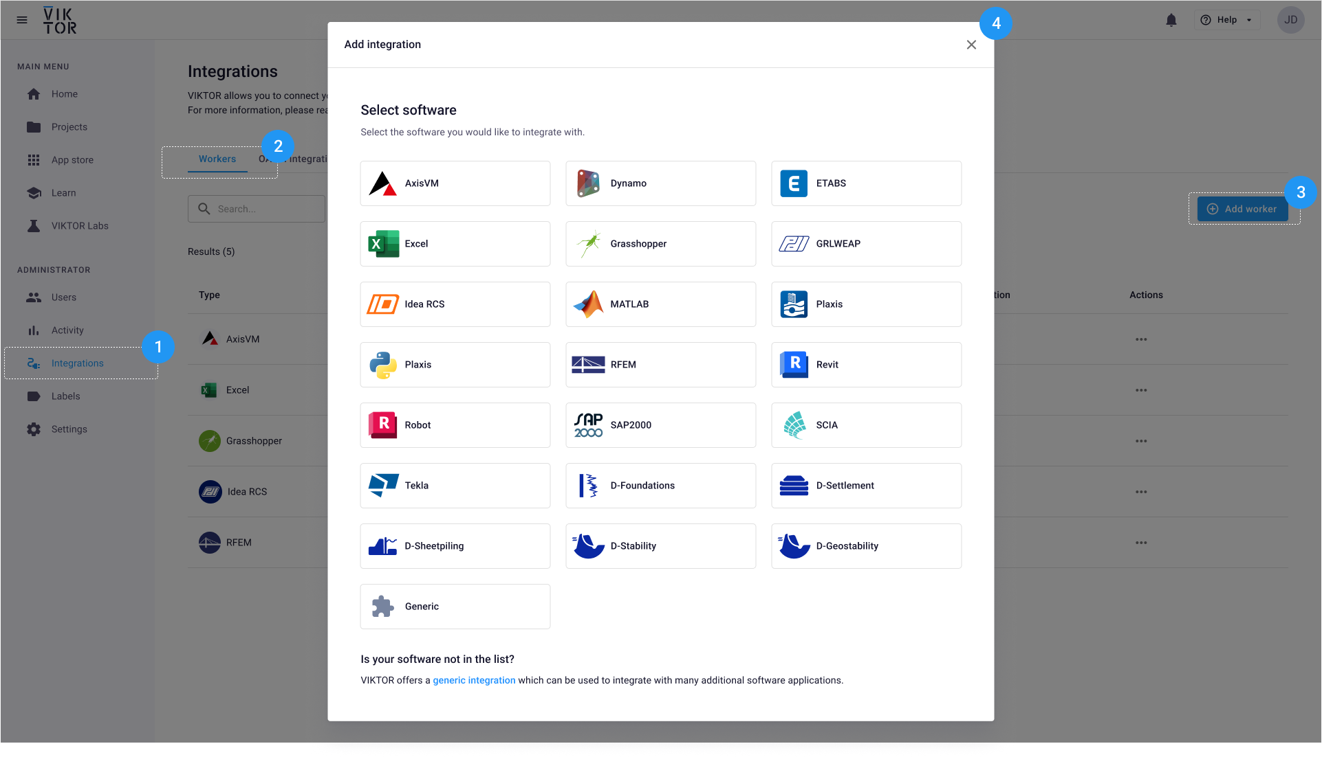

An organization worker connects software that runs on a machine managed by your organization, such as a virtual or remote machine, and is shared by the users of the app instance(s) you select.
You need to be an environment administrator in order to install an organization worker.
Navigate to the "Integrations" tab in the Administrator panel
Select the "Workers" tab
Click "Add worker"
Follow the steps provided in the modal
4.1. Select the software of choice
4.2. Select the app instance(s) the integration should be available to
4.3. Download the worker .msi (Microsoft Installer) and run it on the machine of choice
4.4. Copy the generated connection key and paste it when the installer asks for it

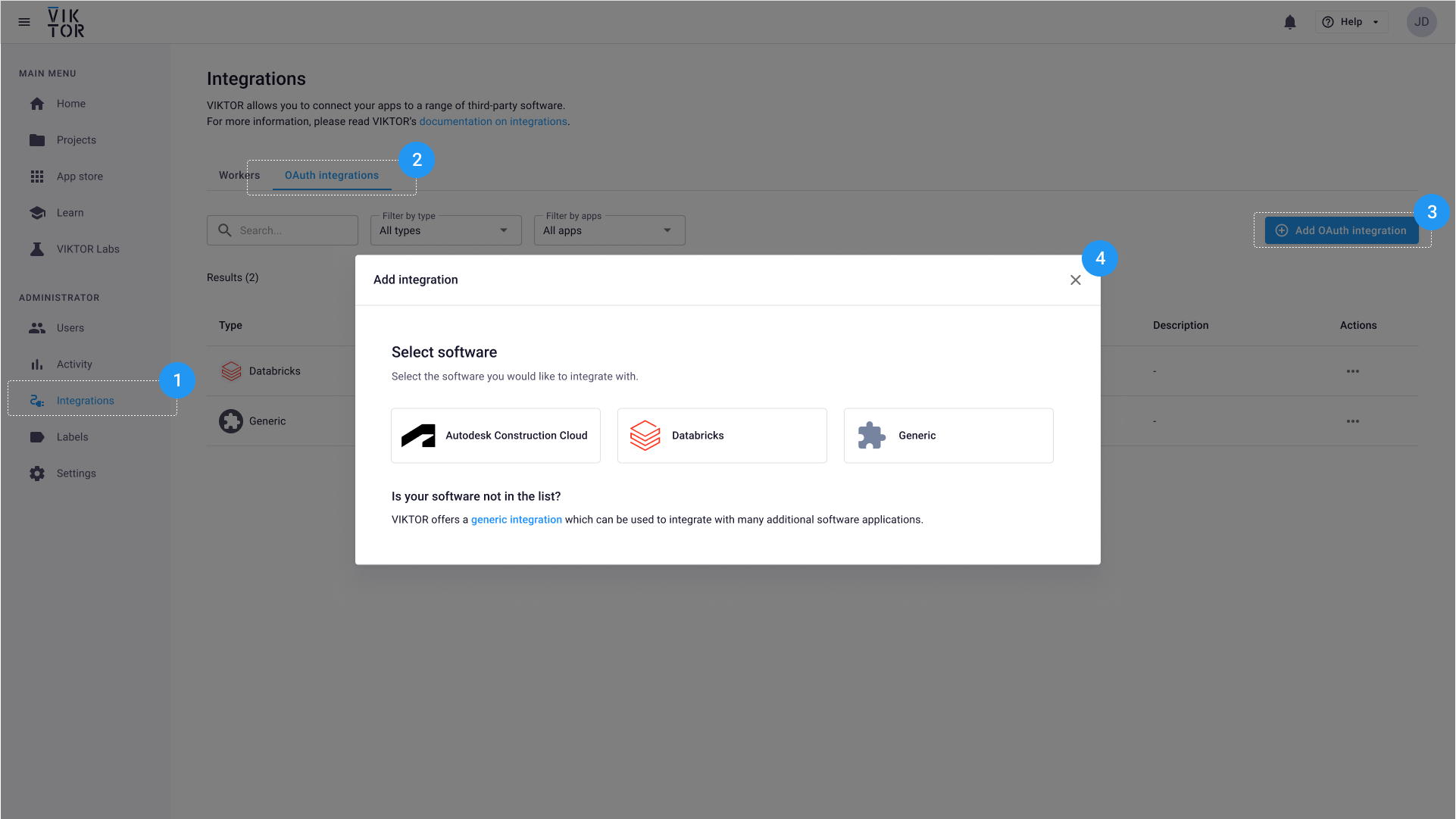

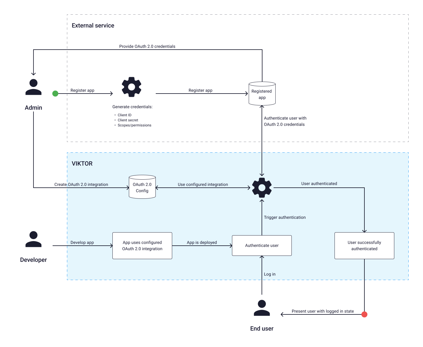

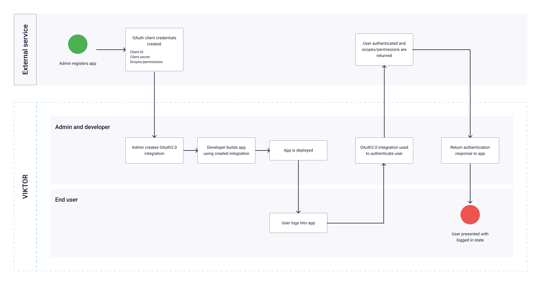

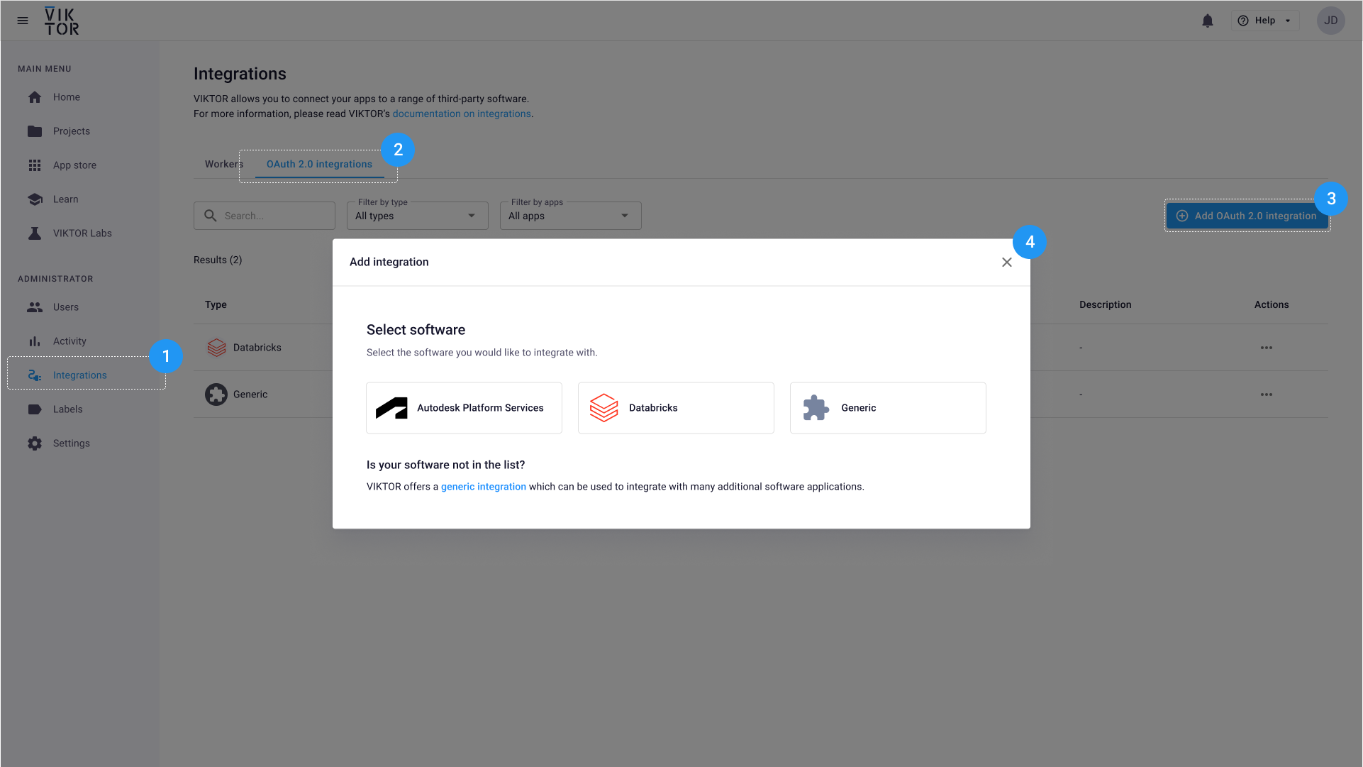

OAuth 2.0 integrations
OAuth 2.0 (Open Authorization) is an industry-standard protocol that allows secure authorization to third-party software, without sharing their credentials. This enables users to access their third-party data from within a VIKTOR application, without exposing their login password.
