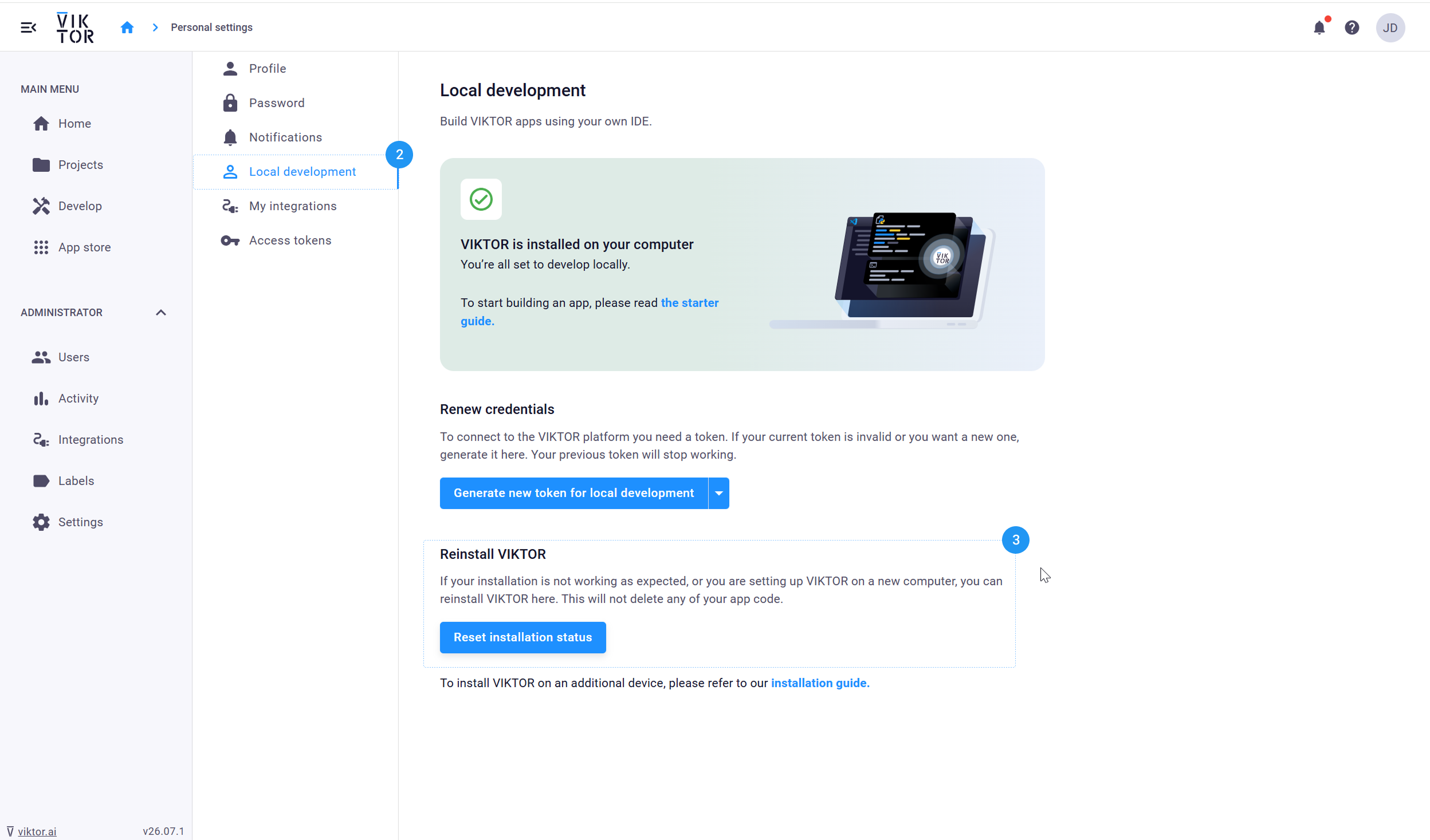

If you need to reinstall VIKTOR (whether you previously installed it locally, used it with GitHub Codespaces, or are setting it up on a new device), you can reset your installation through your user settings.
Steps to reinstall:
  1. Navigate to your VIKTOR environment (for example, cloud.viktor.ai).
  2. Click on your avatar at the top right of the browser and select Settings.
  3. Go to Local development.
  4. Click the Reinstall VIKTOR button.
  5. Follow the installation and account activation steps that appear.
